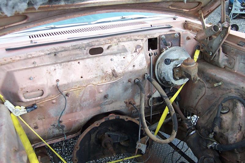

Should have a Midland Ross such as this one on my 65 Satellite.
the problem i'm having is that a Midland Ross booster will not fit in the engine bay with a 426 hemi, which is the engine my car came with. They used in later years the bendix booster with an offset bracket to fit in the engine bay. I have contacted the historical services to see if maybe it was a mistake that the letter stated that it was a power drum car. Anyway, thanks for the information everyone or if anyone has been able to fit the Midland Ross booster with a 426 hemi please tell me how.
