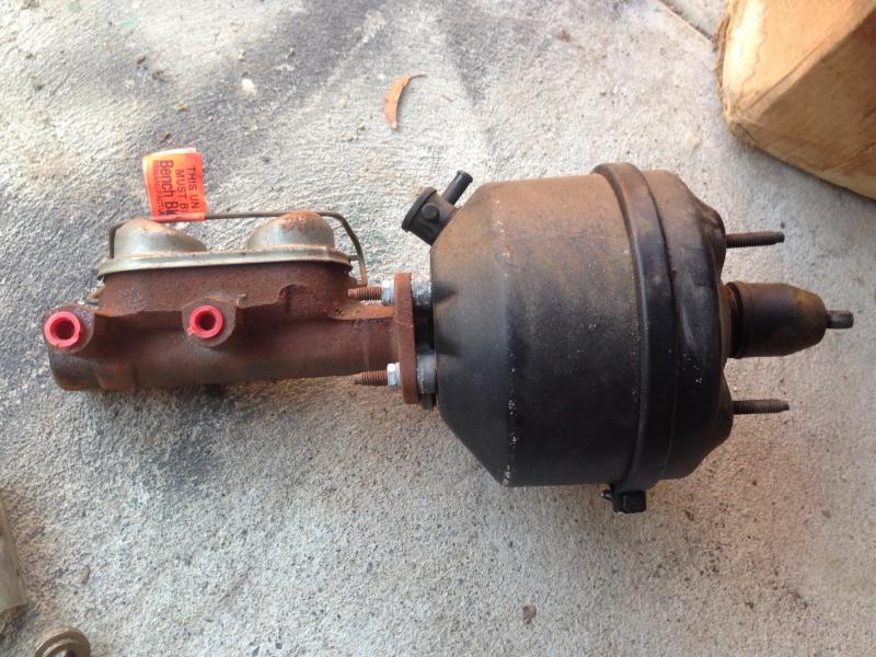

Was told this was a hemi brake booster but am not sure as looks different to others I have seen? Help?

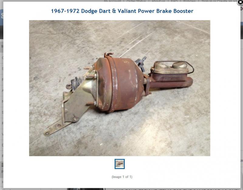

Looks like a A-body booster. That is not the 66-71 hemi booster.

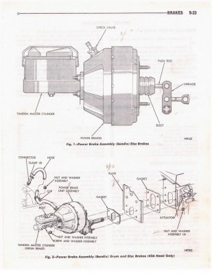

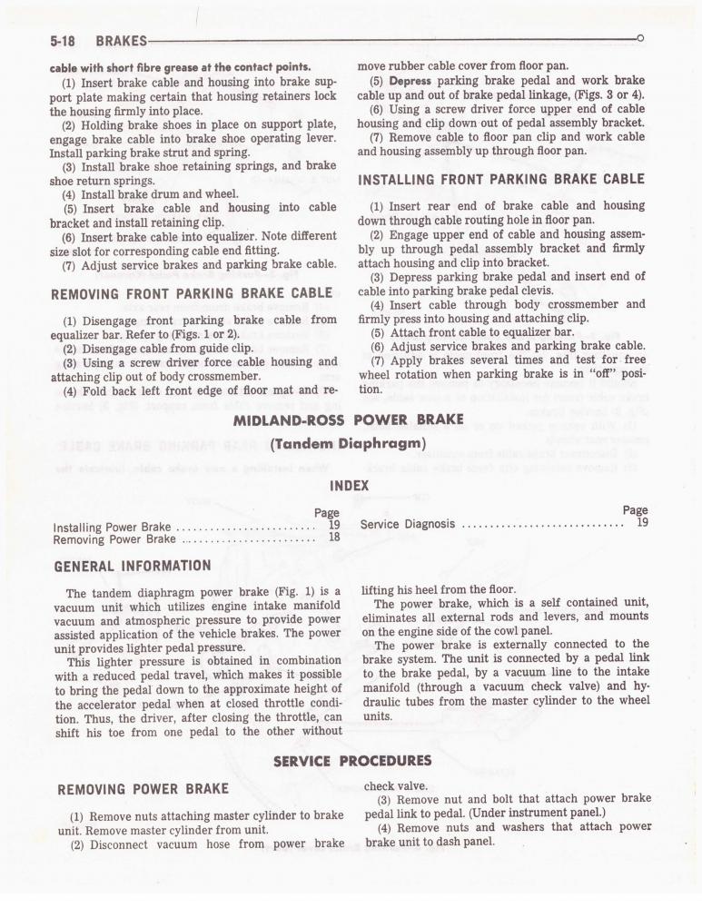

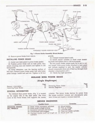

For 69 at least, that pic matches a Midland Ross (Tandem diaphragm) booster for drum brakes. This could have been used on any engine, and is not indicated as Hemi only. The assy for the Hemi Only is shown to be the Bendix (Tandem Diaphragm).
