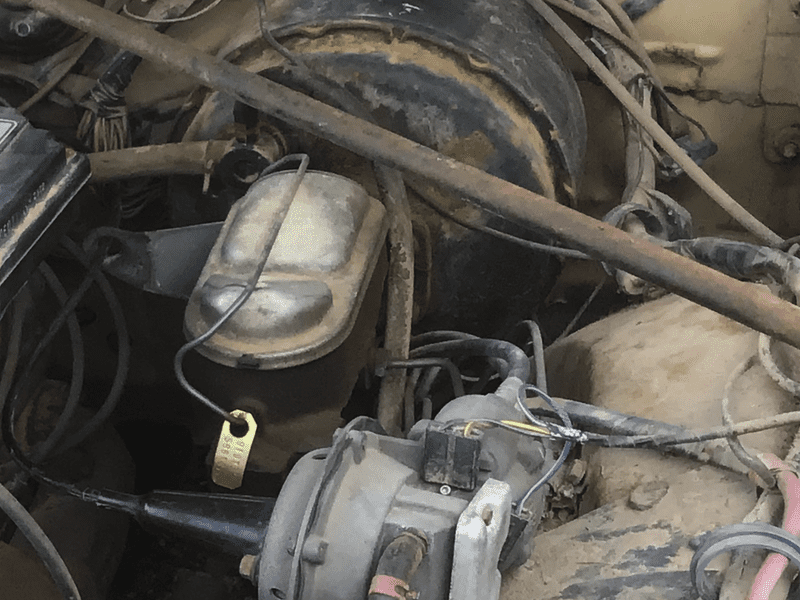

On a 73 Charger, the power steering booster has a vac port on the front with 2 large vac lines going from it. One goes to a vac port on the back of the intake manifold. Where does the other one go? Of the thousand pictures I've taken of the disassembly, I don't have one that shows that.
Thanks
Sounds like you are describing the power brake booster? The smaller line is a take off for speed control. When the car doesn’t have it that gets a cap on it. From the factory.
My water pump is plumbed to the brake booster. Give the guy a break!
Yes, I meant power brake booster. That would explain why I didn't have any information on where mine was connected. Thanks.
