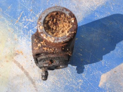

I'm going with silicone next time. I don't want to have to clean up another mess like this. Conventional brake fluid, moisture, and aluminum pistons don't mix. I plan to flush the lines with isopropyl alcohol as I've read that this is the best way to purge the old fluid.

Wow onemore, how long what that in service/leaking? Glycol-based fluids come in Dot 3,4 and 5.1 with each having a higher boiling point but they do absorb moisture and need to be changed every few years but hardly no one does that. The silicone does not attract moisture.

The car sat for about 10 years, in a garage the entire time. It probably wouldn't have done this, had it been driven from time to time. This is an extreme case, but it seems I always see some moisture related corrosion in wheel cylinders so I figure the silicone is worth a try. I think most replacement elastomers used these days will handle the silicone fluid.
