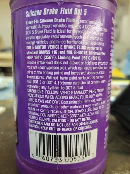

It's been a long time since I've seen any brake fluid that wasn't labelled "Synthetic". Anything you look at on the shelves - Prestone, Lucas, Castrol, Johnsens, Peak, Maxima, STP, they all say synthetic for type 3 and 4.
FYI>Read Rick Erenbergs answer to the fluid compatibility issue. They all must be compatible with the others or there would be huge legal liabilities for the manufacturers.
This is how they deal with huge legal liabilities
