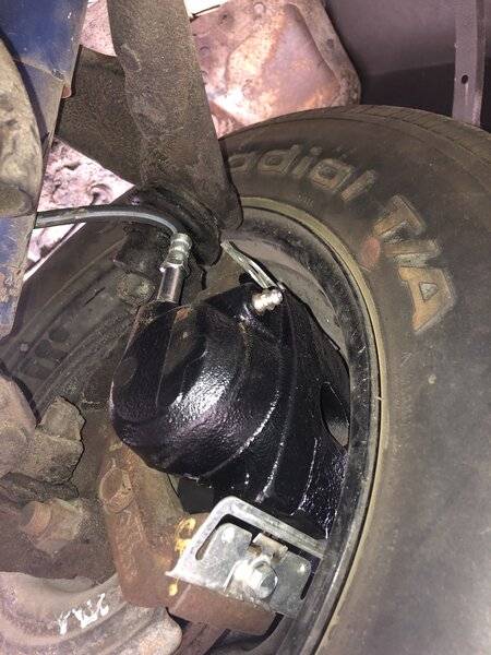

Hi, I’m doing a ‘70 RR clone with a Belvedere and my front brake hoses I replaced run right into the upper ball joints. My previous hoses were a banjo bolt style and looked to be from a diff vehicle. They collapsed internally and had to be replaced. I ran into an issue replacing the calipers too where it seemed they are usually mounted on the back and mine are on the front so they sent the wrong side. Anyone have advice on different hoses that would work? This is the only type of can find for this car so far.

What year are those front brakes from ? 1970 used a guide pin. Those should have a banjo type hose. What is on the other side ? Those tires look to be ancient. Check the DOT codes.

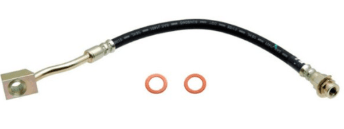

Your new hose is the correct design for a 70 Mopar with disc brakes... But your disc brakes aren't from a 70 Mopar... They are slider type calipers which points toward the very common swapped 73-76 A body disc brakes... Go to the parts store & ask for a RAYBESTOS BH36755
Thank you so much! I figured they were from a different car but didn’t know what. That looks right. You’re the man.
Wild R/T knew what they were from apparently. Yeah, the tires are old.
