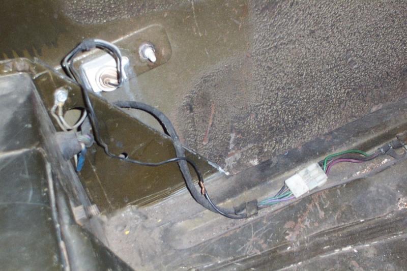

Also, whenever you are talking about grounds for anything tail lights you need to find the ground in the trunk. Should be easy to find....just look for the wire going to the body somewhere near the tail light assembly. Usually around the trunk latch area.
Here is the rear body harness ground. In the trunk on the drivers side.

Should both the flasher and EM flasher be a 552? I cleaned the ground in the trunk area yesterday when I had it all apart, but will ensure it is getting a good connection. Will also check the other grounds.
