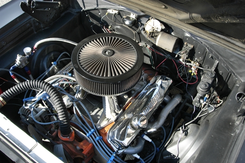

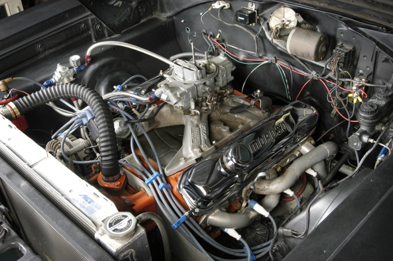

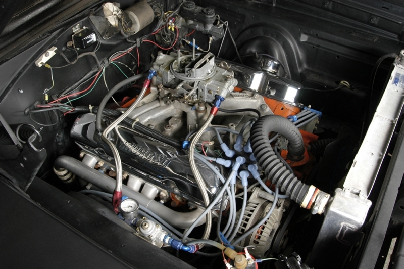

When I bought my car, the PO had replaced the master cylinder under the hood with one from something unknown. When I want to apply the brakes, I have to press the peddle down to the floor nearly and even still I can't get the wheels to "lock up". I've gravity bled the brakes at all 4 corners and haven't been able to get any air out of the lines which leads me to believe there's something potentially messed up with the master cylinder.
Any initial thoughts from any of you guys?
Here's some pics of the MC(sorry none are of it directly.. I plan on snapping some pics of it this weekend)

That MC looks like a disc Chrysler unit, they came in a bunch of sizes. There's a good chance the bore is the wrong size and it will never work for that application.
If it was mine, I would search out the correct MC for the car and application, sounds like a stock setup. Bench bleed it and put it on the car, bleed the res the out.
