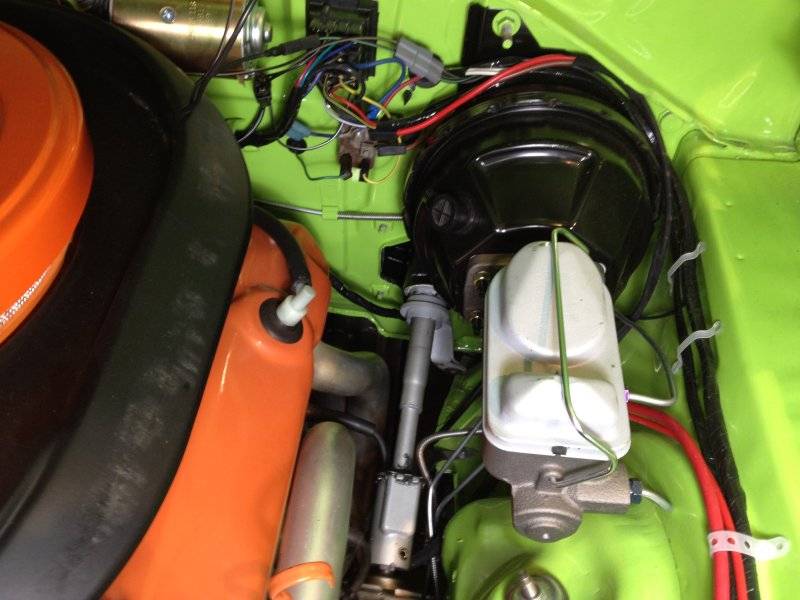

The kit I received had the booster pictured in your second picture. But I didn't like that style - I preferred the type that is in your first picture. So that is what I installed and it works great. Bottom line is I think you can use either - it's a matter of personal preference.

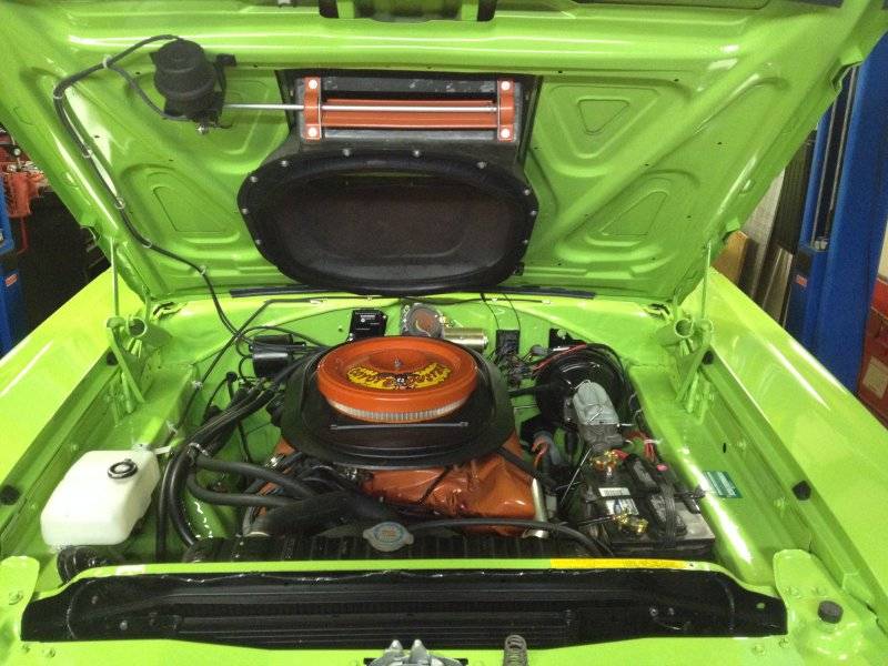

Here are a couple of shots of my engine compartment during restoration in case they are helpful to reference.

Looks good
Pictures are a big help thanks , I’m just wondering room and placement ,, looks like yours tucked right in there ,

It was really pretty easy to install. This is essentially a factory type setup, so it fits and works well. I had no issues with space; it fit right in nicely. Since I converted to a disc/ drum setup, I had to spend some time getting the proportioning valve set right so the brakes apply properly. That just took a few test "panic stops", but really wasn't hard either.
The Mopar front drum brakes are quite large, and I really didn't have any issues stopping with it before I restored the car. But in my case, I wanted to avoid potential brake fade during long trips where I might need a lot of braking. I am pleased with how this setup works and I can stop on a dime. I would do it again.

FYI the cantilever mounted booster and master cylinder decrease exhaust manifold/header heat soak degrading the brakes.

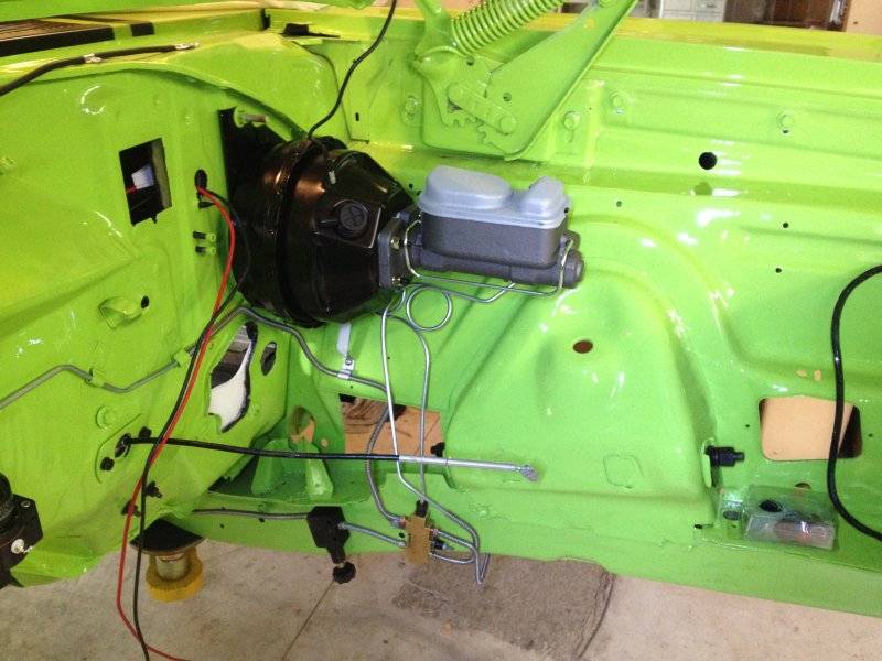

How did you get the old manual plate off? I can’t even see the nuts behind the dash for the studs.
They are there, you have to reach up higher than you think. Below is the plate showing the placement of the studs. Hopefully that helps...
