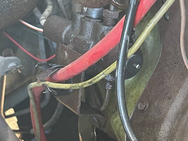

there doesn’t seem to be leaks or an open wire. how do i recenter the switch? have tried pressing the brakes really hard quite a few times and it hasn’t made the light go out

which bit is the switch?
The proportioning valve has a spring loaded clip and needs to be pulled out to re -center the plunger for the light.
ah okay thank you, which bit is the clip, is it the bit sticking out on the end at the right?
thank you! it came out a bit but the light is still on, do i need to re-bleed the brakes?
If memo serves me the pin should be held out while bleeding and the allows the pin to re-center so it is neutral. Someone will correct me if I’m wrong.

If the problem is the internal valve moving over the easiest way to re-center is to open a bleeder on a front and a rear brake at same time and then pump the brakes as if bleeding and that will make for equal pressure on both sides of the valve, and it should recenter. Unequal pressure on the valve is what causes it to move over(low on one side high pressure on the other) Can happen when bleeding brakes
Not sure on your car, but check the e-brake cable and pedal; could have been disturbed with your work. You should use penetrating oil on the frozen nipple for a few hours or longer since the car is braking good. Try shocking the nipple after letting the oil do what it can. An incomplete bleed will likely leave air trapped.
thank you, I tried this and then managed to get the nipple open and after bleeding the backs properly the light went away!
