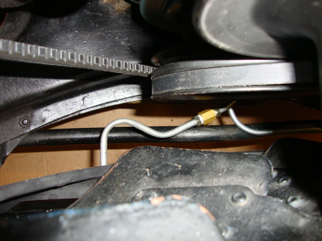

you could give it a shot and see, but since it sounds like you're starting fresh, the flexibility of the braided is nice insurance.
Yeah, ya better weld some tabs to the housing.
