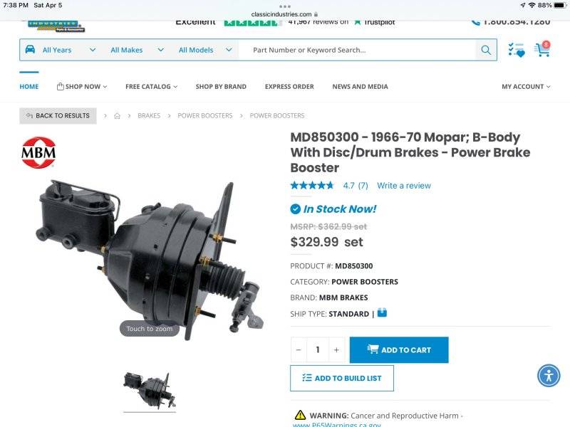

Hi gang,
Working on a 69 Charger.
Replaced a master cylinder and new front brake lines that were looking iffy.
The brakes are stock front disc / rear drums.
I’ve bled the system 3 times with a quart of brake fluid but still have a soft pedal that will go to the floor. The car stops when the brakes are applied but the pedal is way to soft. There are no leaks anywhere. Hoses looked reasonable but not new.
I think I reversed the front / rear brake lines when they were installed but wanted to check if that seemed like the cause to y’all.
I plumbed the rear line to the smaller front outlet and the front brakes to the larger rear port. I’ve searched around but couldn’t find a definitive answer or if both ports are the same.
Thanks in advance for the help!
That's the way they go (and lines should only fit one way!).. sounds like you have air in the nose of the master! Did you bench bled it...
