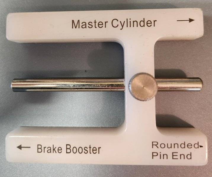

Other thing with the pedal adjustment, make sure there’s no ‘pre-charging’ going on with the booster. This is pedal linkage adjustment. A bit of ‘free-play’ is necessary for the pedal in its home position. This can cause pedal-sink down. You may want to check the MC to booster ‘gap’ if you haven’t, using a booster gap gauge, this makes this an easier chore. Is your ride built up, such as hotter cam? This can create issues with ample vacuum for the booster, I think around a minimum of 17-inches is necessary for most power brakes. Of course, I figure you've checked all the vac hoses, connections, and valve.
Where did you get that gauge?
I bought it a few years ago online as the auto stores I checked didn't stock them, at least then. They're on Amazon for dirt cheap...lol, think I paid more for this one back when! How can this be possible?
