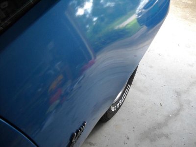

My car is a SS, looks good, but I cant wet sand it due to it being a metallic, maybe buffing??
Hey 5.7!
Sorry, but buffing will not flatten out the surface of the paint. It takes the fine aggregates in sandpaper to cut down the orange peel.
Maybe the OP doesn't care about having some orange peel. Thats okay. It is quite possible that the guys with "driver" quality paint jobs live with LESS stress when they drive their cars! It is quite liberating driving THIS car....

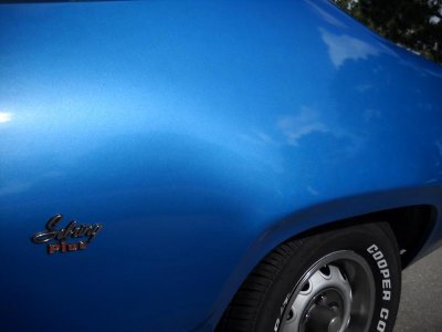

orange peel
I had a few people tell me that I could wet sand my single stage urethane. I am glad I read some of these threads before I got carried away with that. There is some degree of orange peel over most of the car, but I now think maybe it's not that bad and I should leave it alone. Thanks, Ron.
