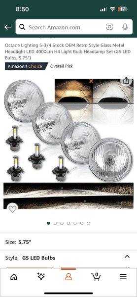

Octane lighting, I don’t have it on my car yet, but there’s a couple members here with them. You can get 4 housings and 4 bulbs for the price of 1 Holley retro led. Problem with Holley, they love to make everything ridiculously priced
