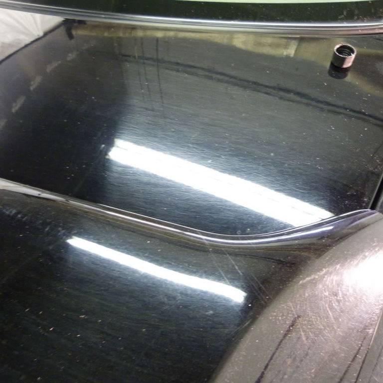

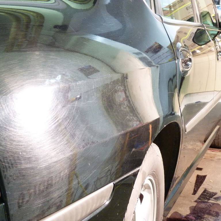

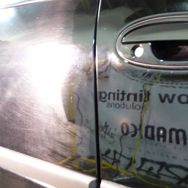

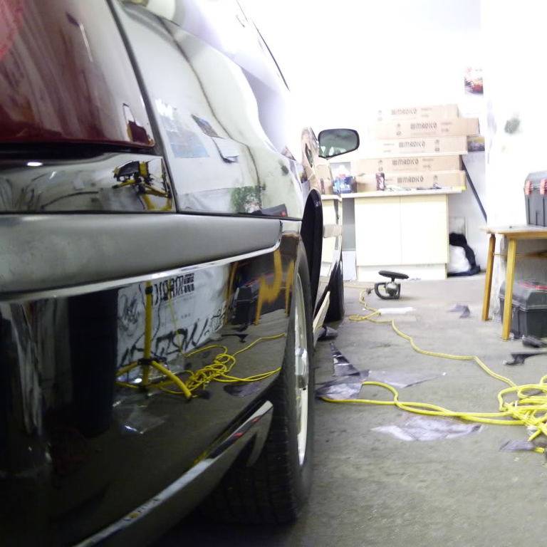

This car has never been waxed or polished it's whole life, and looked like someone washed it with sand paper. Me to the rescue!

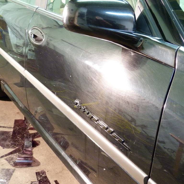

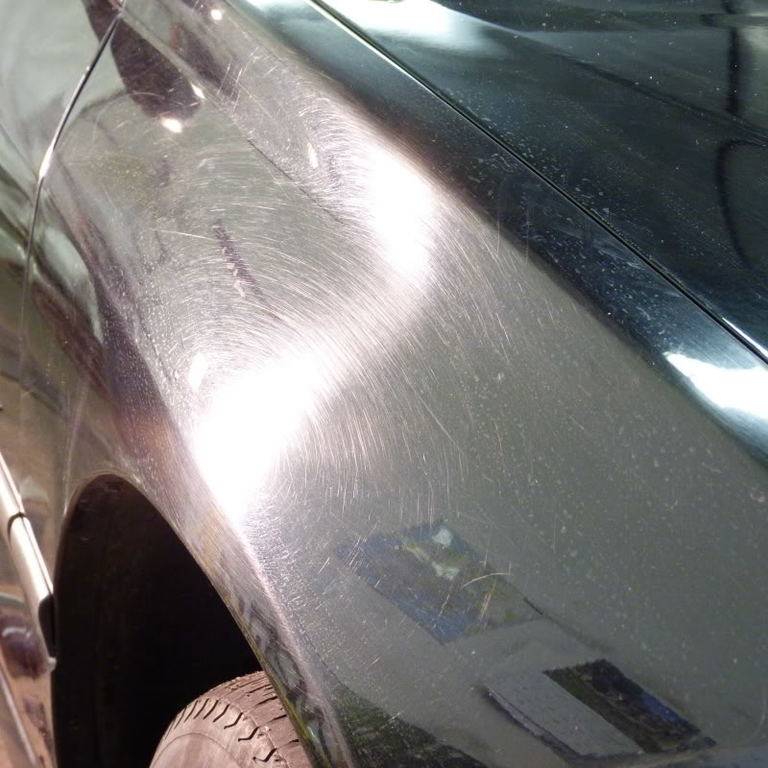

Some before pics:
Trunk/spoiler

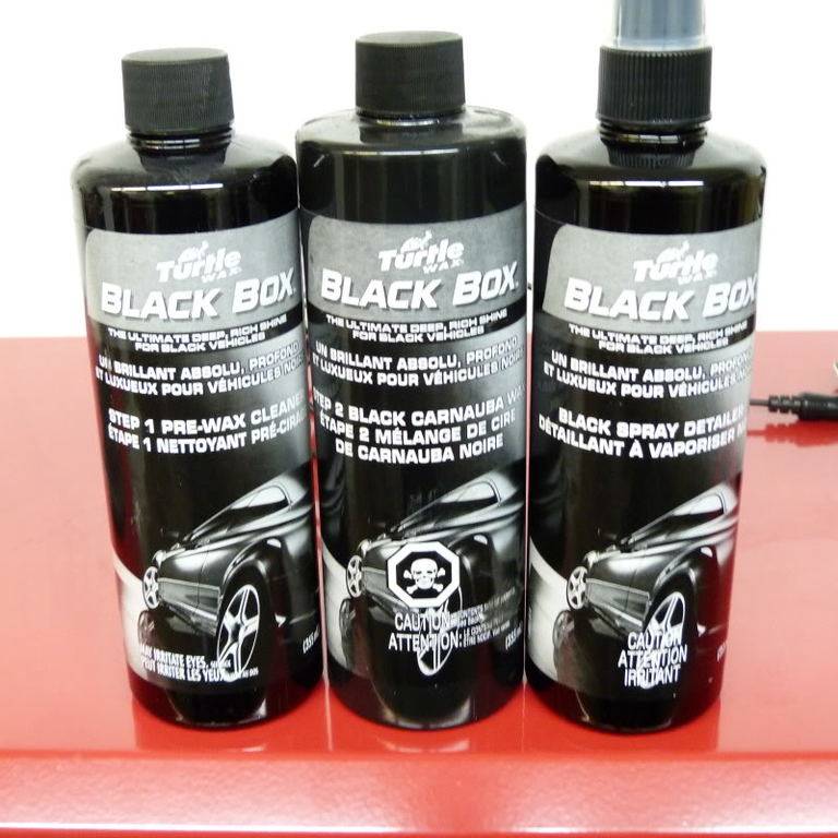

What I used:
I've never used this product before (Turtle Wax Black Box) and figured this would be a good car to test it on. The cleaner, wax and detail spray is black, looks like paint.

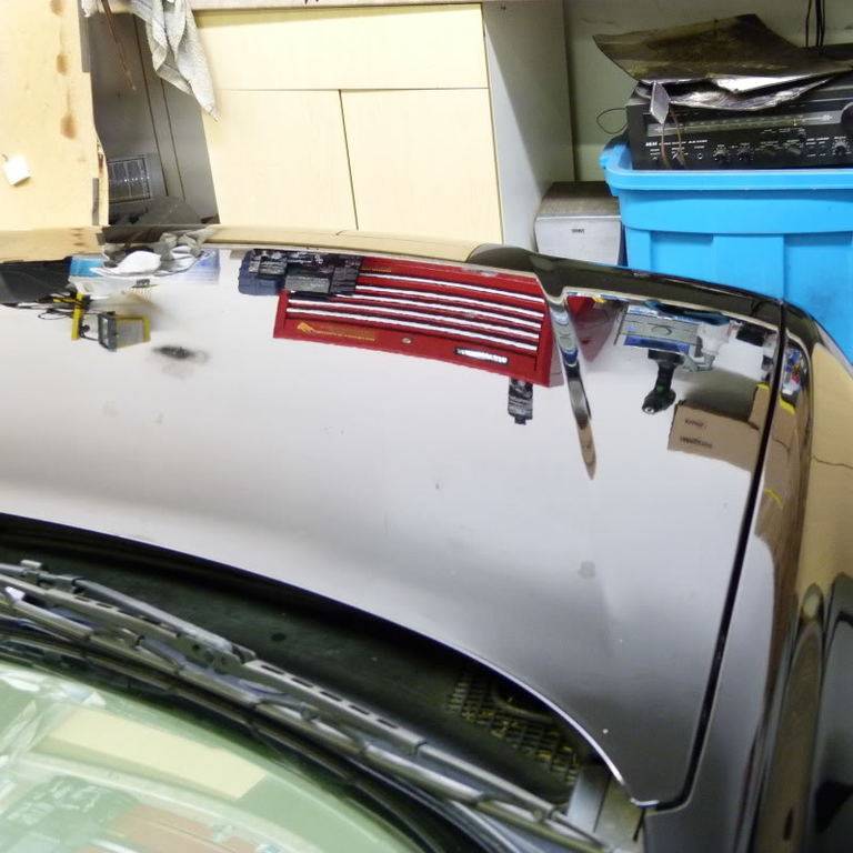

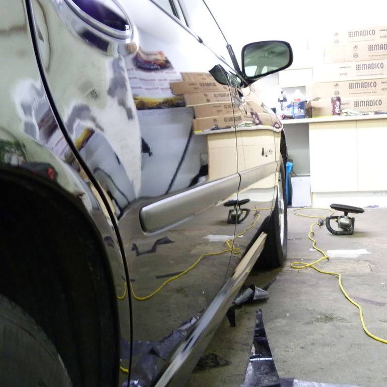

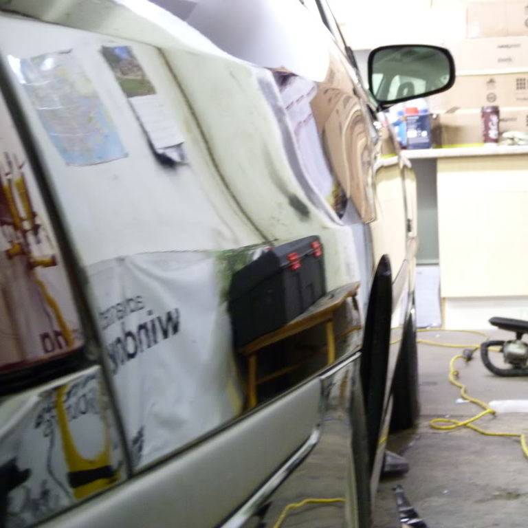

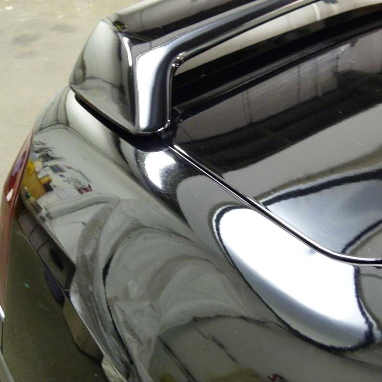

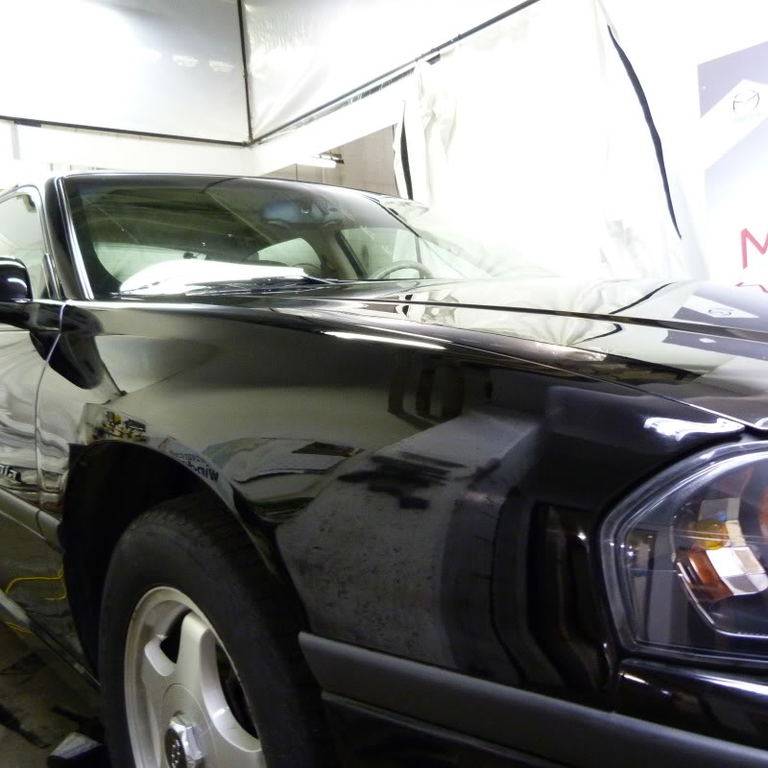

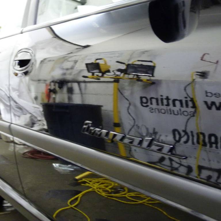

The outcome:
Notice the difference that the pre wax cleaner is already making? man this paint was rough.

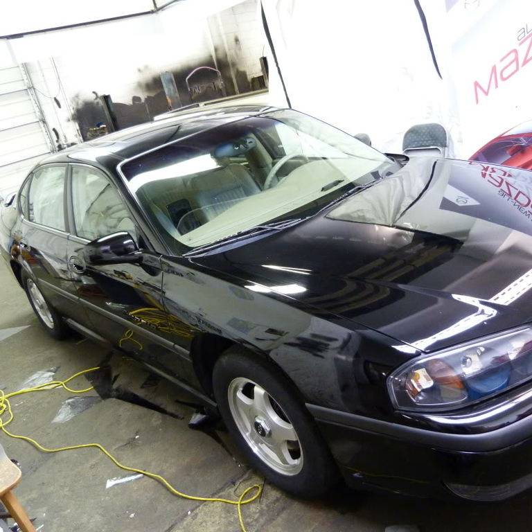

After wax
Still some scratches in the paint, the customer didn't want a cut polish or wet sand with it..
Turtle Wax Black Box.. I APPROVE!
