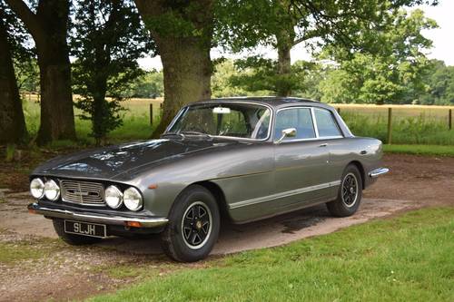

So I have purchased a Bristol 411 that is half way through a stalled restoration. Bristol Cars, for those that don't know, was a small, British car manufacturer that unfortunately went into liquidation recently. It has a cool history in that it was established as a car manufacturer at the end of WW2, when the factories/workforce making bombers/fighter planes in Bristol were looking for new ways to stay employed.
You may wonder why I'm posting on this forum - well my car, which dates from 1975, was built with a Chrysler 400 engine (H400-HC10628) and Torqueflite 727 auto (3926-3840). It has a Thermoquad carb and was marketed by Bristol as having a higher lift cam and apparently produced 275hp. I have a fair amount of history and it seems to suggest that it has only done 40,000 odd miles.
The engine is in the car and I'm told was running well prior to being re-installed. That said I'm keen to do a basic "refresh" aiming for two things 1) to genuinely produce around 275hp (!) and a nice level of torque, and 2) to be as reliable and long lasting as possible. From what I can make out the engine is as it left the factory - no mods at all.
I have some ideas (mainly formed by reading posts on this forum) but rather than lead the witness, would love to hear what you would do in my shoes? Again, I'm not aiming for crazy power - just a nice torquey engine - and something that will last (and that goes for the engine as well as ancillaries). I should say that I plan to keep the transmission absolutely stock.

I just looked up some pictures on line. Neat car. I would probably try and determine what their high lift cam was first. You don't want to over cam it with a stock convertor and rear end gear. You should check the torque convertor size as well.

found a photo one online
I was just curious
sort of a Jenson vibe
Welcome from Missouri!! Learn something new everyday. It does have a little Jenson vibe, I think they used a 440.
