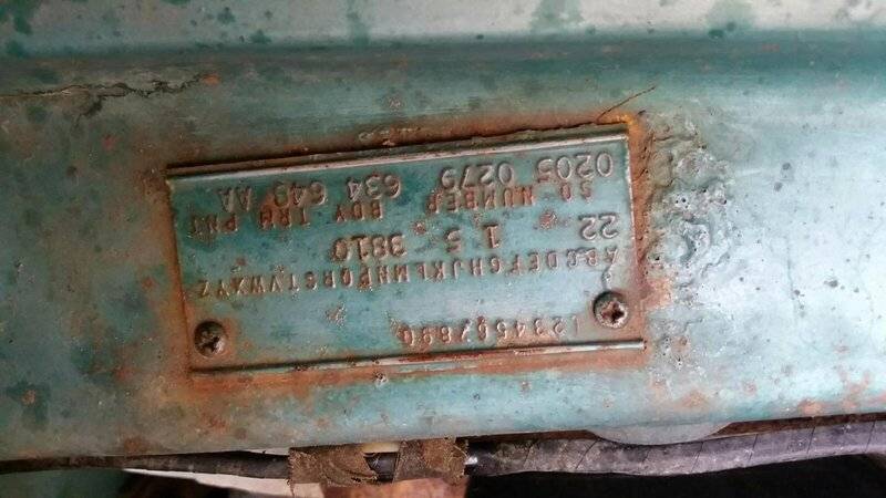

Hi guys, I recently bought a 63 Polara and I cant seem to find any info online. Anything you can decode would be greatly appreciated, th
anks!

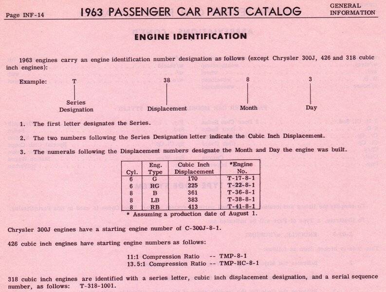

Also, Engine Casting # 21288541...apparently this can mean 361 or 383?
Intake Casting# 2205737..??
Pad under the distributor. All i can see is-
T 38
(maltese cross?)
I (or 1) 29
Is the rest under the head assembly?
Thanks!

T38 = Model year 1963. Displacement 383
1 29 = engine assembly date = January 29, 1963.
Here's info on casting numbers and pad stampings.
http://www.moparts.org/Tech/Archive/motor/36.html
We would need the first four digits of you vin number before decoding your fender tag. (Found on your drivers door hinge pillar.) This will determine what plant it was manufactured. Different plants did codes a little different between each other. Then it will take a little time to go through all of the codes.
VIN - 6332152792
Vin number 6332
6 = Dodge
3 = Polara
3 = 1963
2 = Hamtramck Mi.

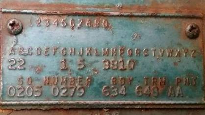

Fender tag options that I know.
2 under the A = code (342) Torqueflight
2 under the B = ?
1 under the G = code (361) AM Music Master Economy
5 under the J = code (385) Heater Front with Defroster
3 under the M = ?
8 under the N = ?
1 under the P = ?
0 under the Q = 383 1- 2 bbl. 305 hp.
(The number under a letter is the last digit in the three digit code. Each letter is designated to a certain item. Like the "Q" is Engine, "G" is Radio ect.) I don't have any info on the "?" items. Maybe someone else will chip in.
