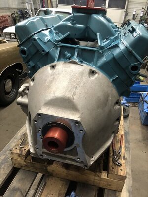

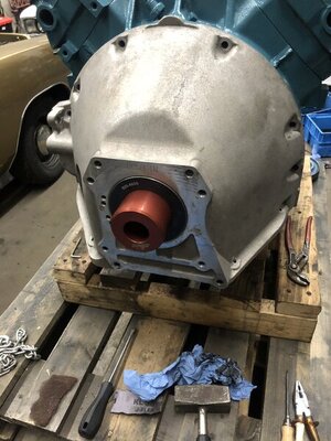

For my peace of mind, for me to be able to irrevocably state as FACT that my bellhousing is within less than .010 of dead center, I bought TWO Browell bellhousing runout and alignment kits, one for MOPAR and one for PONTIAC (GM)...
It's a VERY nice chunk of billet aluminum, the black and aluminum colored ring that goes around the red "bowling pin" is the piece that Browell machines to fit just a teeny bit smaller in diameter than the hole in the bellhousing.
Bolt the red part to the crankshaft and position the bellhousing in place. If the "ring" doesn't slide through the hole, use whatever offset dowl(s) are required to make that happen. Put a light in the bellhousing to make any gap easy to see.
Once the proper dowels are in position, if need be to assure they don't budge, use a little LocTite. The RobbMc dowels should not require any LocTite because of the allen bolt that spreads them to tighten them into place.
At around $175 each, well worth KNOWING vs the frustration, cost, and possible warranty rejection due to an out of spec runout alignment.
The Browell tool is basically a GO/NO GO tool. Quick turnaround and good tech support.

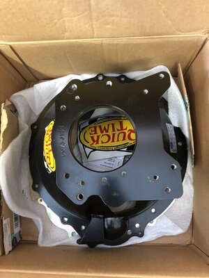

Very nice, used it last. Comes with adapters for different sizes.
Soon I will dial in my Qicktime bellhousing with it;)

The one in my pic is my "standard" 4.807"
Mopar tool. They asked me to measure the crankshaft "register" but I wanted to roll the dice on the Pontiac/GM and my Roadrunner, and they made that easy by saying that if the measurements were different they would remachine the parts for me.
As long as you know the size of the bellhousing hole and the crankshaft register, even if you have to measure them, they will tool up whatever you need. I guess that when I switch to a scatter shield bellhousing, I'll have to get another ring.
I'm 100% satisfied with this investment.
