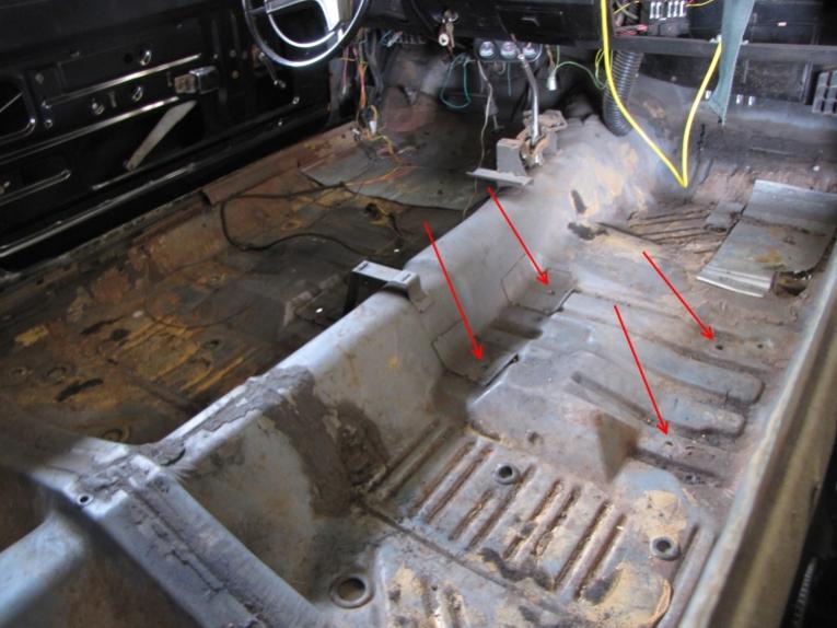

It appears that my car had the floor pans replaced by the PO and he then mounted some mysteerious buckets with different mounting location than original.
Can someone provide any guidance on where the holes should be for a set of original buckets? and maybe a pic of the floor pan with holes for reference?
Much thanks in advance.
Not sure how much this may help Gear, but below is a pic of my RR's floor before changing it out. It's a factory bucket car as well. Easiest way to put it is, the outside holes run through the floor right where the floor reinforcement brackets are underneath. The inside holes obviously lie parallel with those hole. Sorry I do not have any measurements.
A factory Bucket car also has the Plated on the floor for the insid emounting holes.
Thanks Prop, that helps a lot... good starting point. I will have to pull the carpet bck and check, but if I recall, there are no reinforcement plates, but as I said, I think the floor pans were replaced. I will have to weld some in.
Can anyone give me a measurement from edge of the pan to an outside hole?
I will get you the # this week when I get to the shop if you like.
No sweat! AMD sells those reinforcement plates Gear...Easily found on the internet or from folks like Jeff at 521 restorations.
