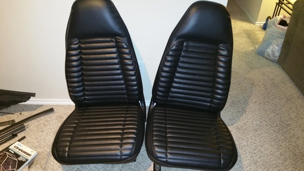

Here is a pic with mine finished out. My passenger is slightly fuller than the driver but both turned out nice. This was my first time doing this.
You re-covered them yourself? They look very nice!

I did and thanks! I am not positive but I think the main difference between the 70-71 is that the back frame has springs and 72-74 seat backs do not have springs so the padding is made differently. However the covering process should be the same once you get the padding on.
Maybe they say 71-74 because you don't need the springs with later models and they assume you take the springs out???
Not just that. The shape of the foam is diff to to fill the diff covers!
