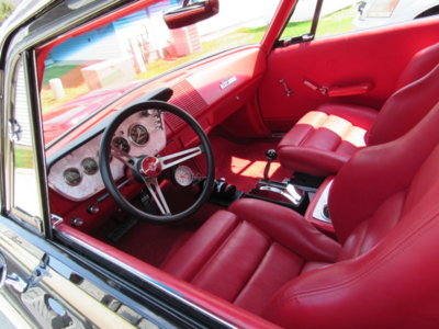

Those look great, I've been looking at them for my 69. What harness are you using?
The harnesses are Jim Deist four-point racing belts from the 80s. They're bolted directly to the floor. Look and feel great!
