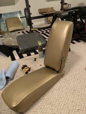

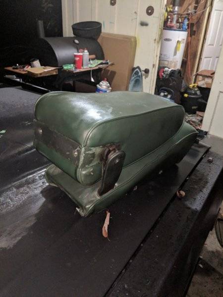

I'm in need of the locking stud, or bar ( or whatever its called ) for the buddy seat out of hte 67 coronet. I'm sure more than one model year would apply, but its located near the hinge area...and mine seems to have lost it....or them....
If you look at the top of this hinge in this pic, you'll see it peaking out.

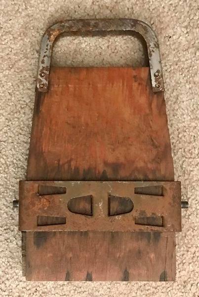

I have this bottom. Not sure if the uprights are the part(s) you are looking for.
Other part sir, the non post side
The studs that stop the top
Should be fairly easy to make those pins? I also thought you were looking for the flat bars
How the hell did the bar fall out??? Lol

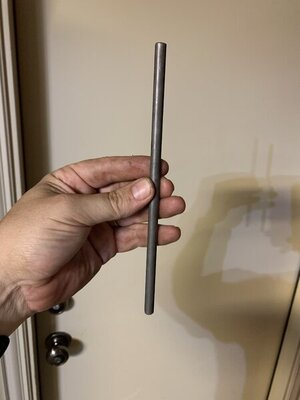

If my measurements were correct, it's 5/16" in diameter and 9 to 9-1/4" long.
Which one of you machinists out there can whip one up?
looks like it has a slight groove on the ends?
That groove is an optical illusion. Here are a couple more pics:
100555605488_n.jpg?_nc_cat=103&_nc_sid=b96e70&_nc_ohc=yNyucbr07Z0AX83W9Ee&_nc_ht=scontent-ort2-2.jpg
116853957488_n.jpg?_nc_cat=108&_nc_sid=b96e70&_nc_ohc=IaUIyhcAyLsAX_XCQzi&_nc_ht=scontent-ort2-2.jpg
Boom, fixed
Lay the 5/16 bar across the pillars with a 16th for tightening. Cut, filed and it fit right in there.
