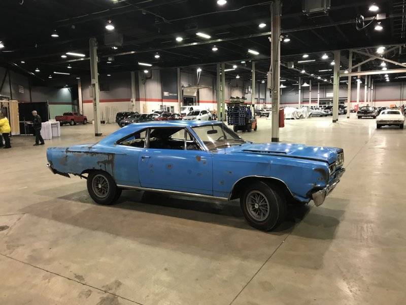

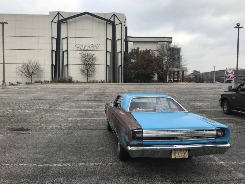

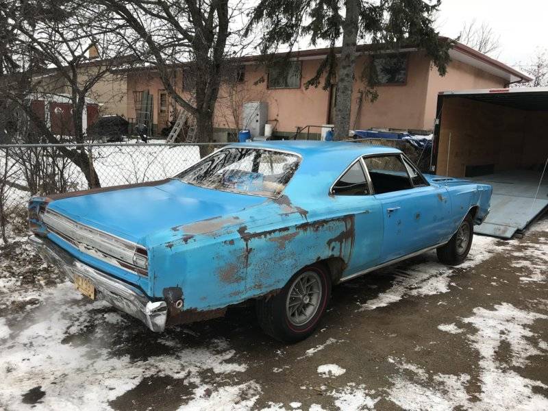

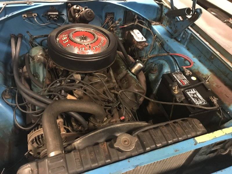

A few pics from last fall.
Did this package add the bright grill also?
All of the 68 Road Runners used the same style dark argent with black accents for the grills. For the finish panel, the Road Runners used a dark maroon color to match up to the tail lamps. The Satellites used the same panel, but the maroon color was black. I cannot tell from the pictures, but does this car have the B-pillars in body color or does it have the stainless trim covers?
