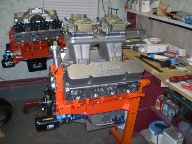

You just need the block unless it has decent heads that can be used. 400 block, 440 crank and rods and then you'll need special pistons. Fortunetly this is a very popular combo and pistons are readily available, I used KB's in mine. The 400 rods can be used but I prefer the longer 440 rods for less piston side loading (less friction). The crank will need slight clearance work and the mains turned down to the 440 size and then balanced. This is a very affordable engine to build seeing how most of the extra machine work is stuff you'd likely do on any motor with the exception of the clearance work on the crank. The 452 heads are good flowing heads with hardened seats that will save you a little and money, the 906's are a little better without hardened seats. Mine is finally running and sounds nasty.:headbang:

747 you got any videos of it running?
