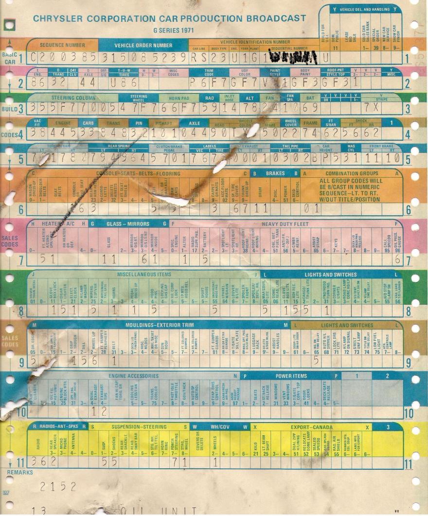

Can anyone tell me what all the codes mean? Can figure out some of them but some I have no idea. Thanks. Andy

It is WAY to time consuming for people with the knowledge to do it for you. it takes far longer to do than decoding a fender tag even if you have many of the codes commited to memory.
Buy GGs Chrysler Corporation Production Option Code White Book
Most of the codes are very simple to figure out.
Example:
Line 2 first two boxes 86 decodes as option sales code E86=440-4 for 1971
See the codes above the box with 86, the top one is E for the first code character and the "engine" below it tells you verbally what the option is.
Many of the other codes that are more difficult to determine are are partial part numbers for the items they are coding. some are partal parnumbers for complete sub-assemblies and are not found in parts books or anywhere else other than the factory back in the day.
Example:
Thanks 696pack, I'll keep an eye out for his books.
