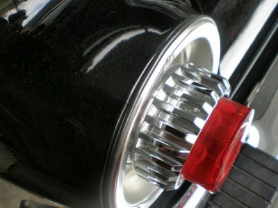

I figured that the dome bulb would be the same since it works in the same manor. On a different line, who has the rubber outer edge seals for the tail light housings?
Bob,

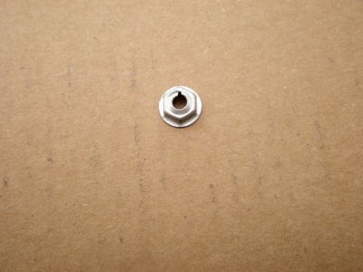

On your tail light housing,I used 3/16" window washer hose,split it and it looks identical to the origional.Also,most die cast emblems/script used self threadind 3/8 pal nuts.Measure the pin size and let me know,I have a lot.
