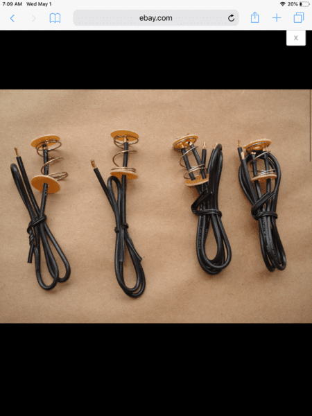

Has anyone ever attempted to rebuild the internals of a bulb socket? Found the rebuild parts are available. You can get single or double contact internals.
No but would be a simple task. Slide the old guts out and slide the new in. Splice in the new wire, done!
I think the “harder” part could be insert the bakelite tabs into the socket channels without break them
I've seen people bend the crimp away and pop the whole socket out of the housing
then expoxy glue in new sockets..
Yeap that’s the tipical fix but usually replacement sockets are without ground wire to the socket body. With plastic housings if socket is good replace the inners could be a good solution and save from the ground wire attachment deal. Won’t really matter on pot metal housings, althought using epoxy glue will isolate it.
I “PUSHED THE EASY BUTTON” and have a nice complete housing coming from Mark out west.
