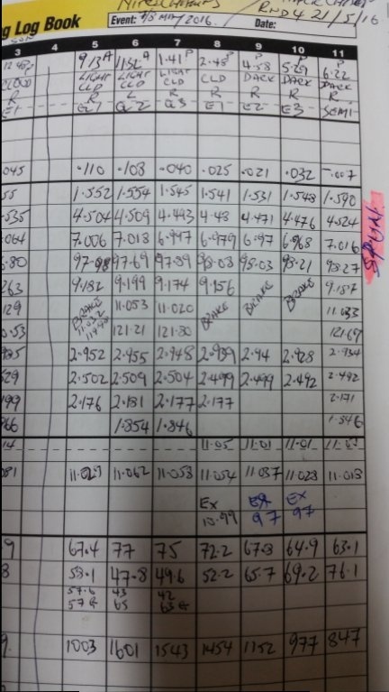

This was 2 weeks ago Budnicks . A bit soft in the 60 . Shame about the James Bond cherry in the semi

Good luck Tex. Your car runs very good now for what it is so I think you will tune that 505 to 10.50's or better once you have it dailed in as you seem to know what you are doing. Ron
