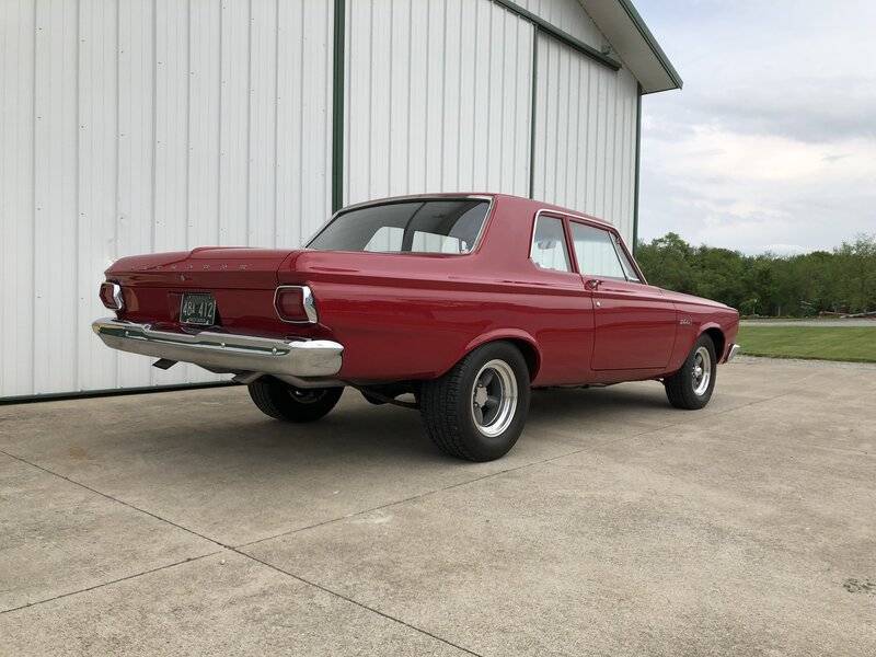

I have a 65 Coronet. Are the Belvedere bumpers the same? Or is it 1 year only on the coronet?
Thanks
Not familiar with the Dodge version, here is the Belvedere bumper. Hope this helps. Fronts are not the same.
Google pictures on the 2 cars. Looking at that I say no.
Thanks
65 Coronet rear bumper is the same as a 64 Polara rear! Ply. rear bumpers interchange from 63 - 65, Front bumpers are a 1 year only! Both Ply. and Dodge
The 64 Plymouth rear bumper is different than the 63/65, the outer bolt hole is moved in about 3/4 of an inch to center it under the taillight. The outer bracket is also different. Otherwise they look identical.
