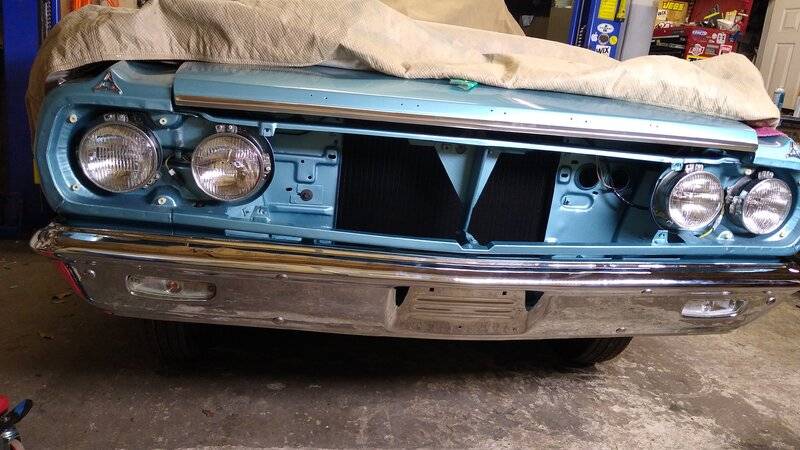

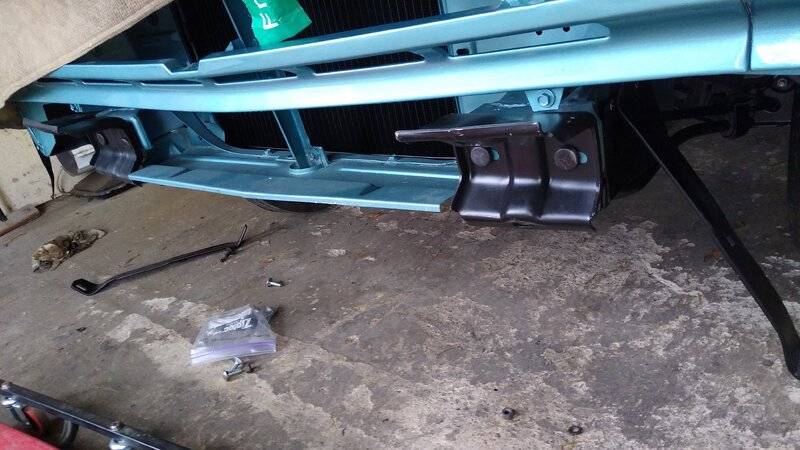

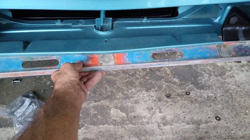

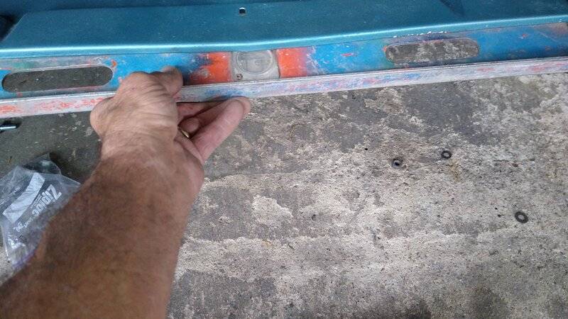

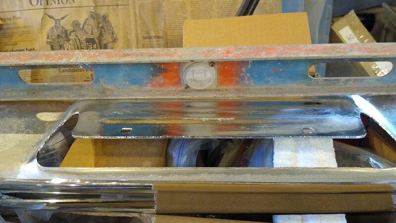

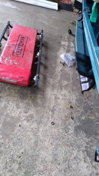

Installing front bumper on my 65 coronet. For some reason the middle of the splash shield is hitting the back side of the bumper. I think all my brackets are in place

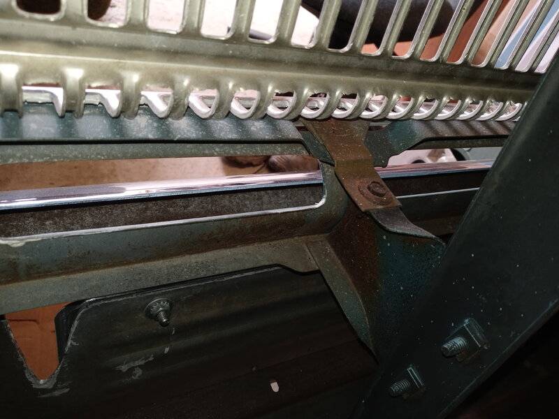

I can look tomorrow at mine for some reference...
Think I see the problem. The bolts mounting the air sheild to the core support are mounted from top down. Needs to go up from underneath. I swap it out tomorrow. Hope it that's my problem
Flipped the bolts around and it helped. Still had to do more tweeking

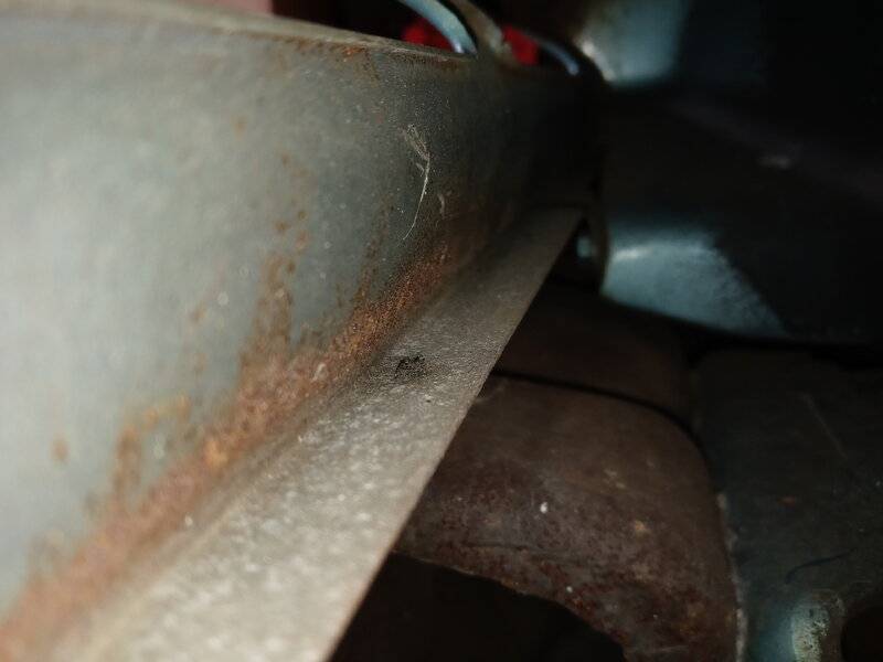

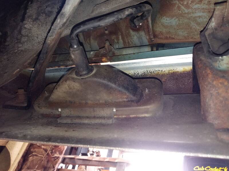

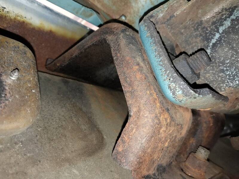

I looked at mine today, but couldn't see much for your needs. Tried a few pics, but the lighting is dim at best. I can check specifics, if you need to, this is a survivor...
