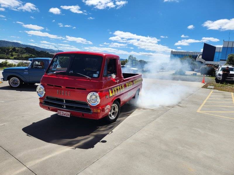

That skid ended up being about 133 washing machines long. :lol: Had to back off before hitting the end wall.
