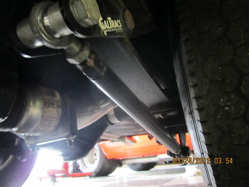

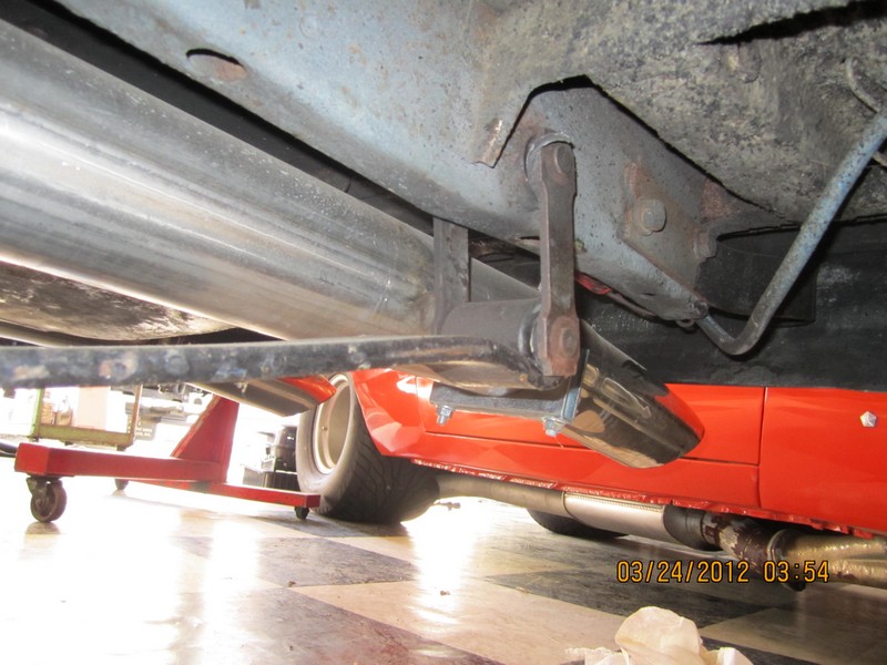

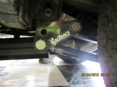

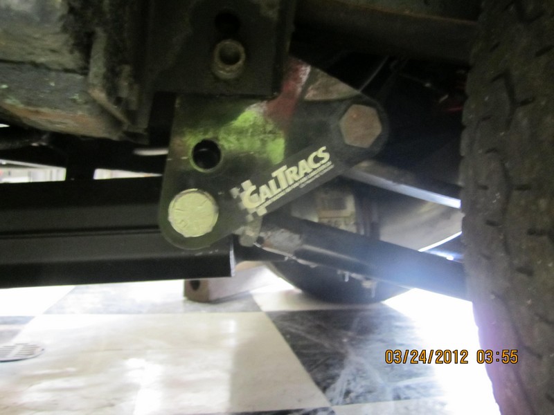

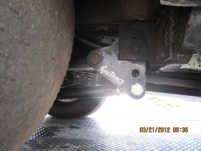

Unfortunately I'm using the stock front hanger so no info with the two hole set up. I ran into the situation use described and took everything out and sold it before even trying as I didn't like the way the car sat- too high in the rear and shackles pointing foward.
I can tell you that the 22 inch front section is what I have and I also use stock rear shackles. The are articulated correctly- straight up and down with a little tilt to the rear so when launching they allow movement foward.
I purchased the springs and Caltrac bars from Calvert directly with great customer service. I'm using QA-1 adjustalbe shocks as well. 1.44 best 60 ft so far at 3750 lbs. 10.27@ 131.56 best pass so far.
See result in pic below:

Mine did:sunny:I was under the car yesterday:eusa_dance:
