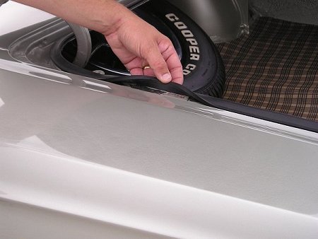

The trunk stamping number is on the driver's side under the weather stripping. It may not be possible to read it without pulling up the weather strip.
Sometimes the stamp is deep enough to be visible on the under side of the metal by holding a mirror under the rail where the number is stamped.
