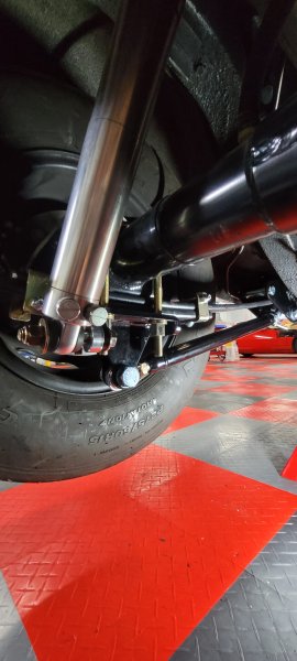

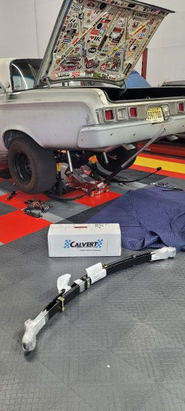

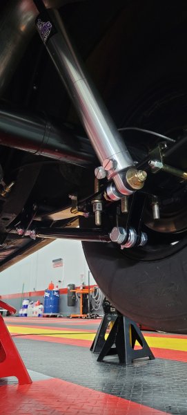

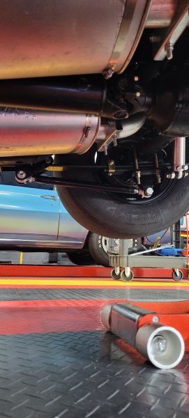

So I just ditched my 454/455 3800 lb super stock springs for Caltracs and split mono's. Just wanted to get some advice on a good starting point as far as pre load on the bars and also shock settings on the double adjustable vikings in the rear. Car weighs 3915 with me i
n it and a best of 10.97 @ 121 and a 1.51 60 ft. Stock front suspension with 6 cyl torsion bars and cheap gabrielle shocks. (Thinking about going double adjustable up front too if need be)

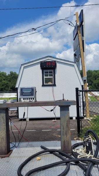

Sounds like you've got about 250~300 lbs hiding in there somewhere.
My apologies 3910. But this was at cecil county dragway right after I got my time slip. 3/4 tank of gas. I'd like to think a NHRA track's scale isn't too far off but ya never know
