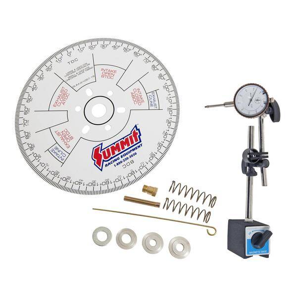

What are you all doing for a Cam degree wheel? I hate to have to buy one just to use it once since they are over $100 for a kit. Is anyone out there willing to loan their wheel out? Obviously I will pay shipping charges.

Summit Racing SUM-G1057-16
$25 plus a bit of shipping, and you don't have the headache of returning a damaged tool to someone.

Thanks, for the suggestion but the wheel is only part of what is needed to truly degree in a cam. Such as, the wheel pointer and the travel indicator. Since the engine is out of the car I might as well do the job right. If you have a to make all the tools in a cam kit then I am all ears.

From my understanding the larger the wheel the easier and more accurate your degree will be. I was thinking about using a homemade large wheel with the smaller parts from the degree kits such as the one that BeepBeepRR showed.
Seems to me the Summit 11" wheel in post #2 is real good, I have a similar one from Jegs. You do need the dial indicator/magnetic base. That's the important part. I made my own pointer from welding rod. Checking springs are available at the local hardware store. You also need the piston stop to set TDC correctly.

You can make the pointer out of a wire coat hanger.

Larger diameter just puts more space between each degree mark making it easier to read. The large degree wheels are nice when the engine is on an engine stand.
The smaller degree wheels will usually clear if working with the engine still in the car.
The expensive degree wheels are usually thicker and more rigid and have less front to back run-out.
The thin or printed degree wheels can get warped easier so the pointer may have to be further from the wheel, makes readings more difficult due to parallax.
Need a piston stop or dial indicator setup to establish TDC.
A dial indicator setup with a long stem rod extension works good.
