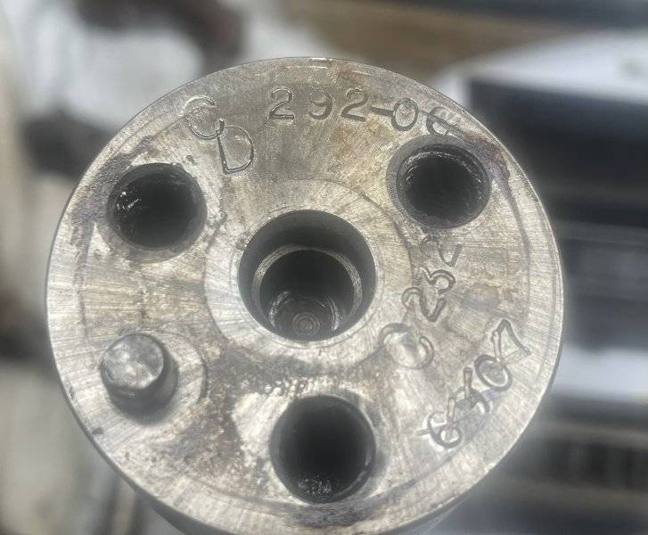

Would anyone happen to have a cam dynamics catalog that might still show this cam number? I’m looking for all specs related to it. Photocopy of catalog page would be great if possible. Thanks

My CD catalog does not list a 292* cam, either 290 or 300*; could be a custom grind.
Oh, that’s interesting. Thanks for checking. I did pull in out of a 426 Hemi if that makes a difference in the catalog section.
Measure the lobe lift and see if it's .330". Bet it's another generic crane lobe with something like 290 on the seat and .490+ lift at the valve with a 1.5 rocker.

could be 292 duration@ .006 and 232 duration @.050.
Good idea I’ll try that this afternoon. Thanks.
if it is the cam in my book it will have 320 lobe so 480 lift. intake and exhaust
