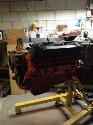

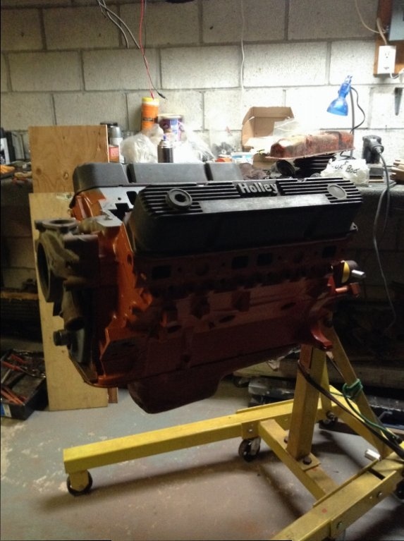

Just a quick pic as everyone on here likes to see what we are building
I'm just trying to build a strong 440 with good bottom end response n exceptional mid range torque
