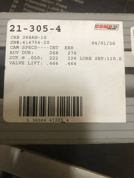

Hey all, I am looking for some suggestions on what cam to go with. I'm planning on keeping it pretty mild. I was just going to do a stock roadrunner cam with KB 240 pistons and a Edelbrock 1407. Other than that is basically stock. Then I realized the 68 roadrunner cam I was going to put in had some chips on the corners of the distributor gear, so I am going to go with something else. I was thinking the lunati voodo 256/262. I just looking for a weekend cruiser I have 235 or 245 gears I believe id have to check again. Im just looking for a little lope. Let me know what you guys think. Thanks.
Comp Cams sells a magnum muscle cam with "aggressive" idle.

I red X’d your reply only as a possible problem that may crop up and that is the torque converters stall in a. Emissions era car with the reported 2.45 gear ratio.
What you listed would work 100% fine with a older non-emissions or low emissions era car since that cam is a copy or there rendition of the factory HP cam. That cam was coupled with a higher stall converter than the late ‘70’s car came with because of there non performance nature and build like low compression flat port heads (as we called them. AKA junk) small valves multi ported / vacuum port carb and Catalytic converter’s —- EEEKKK!
The KB-240 slugs help out but there is still much left to this build that is unknown. For me at least, I find it hard to use a bigger cam with those 2.45 cog’s out back!
Also, those cams DO NOT! have an aggressive idle. There typical hot rod cams. Nothing more, nothing less.
