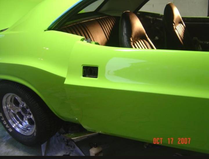

This is my first post...I have a 440, about 15+plus years ago I installed a comp extreme cam xe274H.. I bought my car with an installed 3000stall converter, previous owner had a 3500 stall but said it. Was to much.. with that in my memory I selected the xe274. Well. That didn't go well I bent I think it was 4 push rods..I don't know if that cam was to big, or perhaps I made a error on the install.. but it's been some time and and I want to replace the cam and lifters, but I want a trusted brand that some of you guys may have used. I would like to get the 214/222 dur 444/466 lift... the added pic is when my dad painted it. Drove it less than 100 miles since. I got it my senior year of high school
