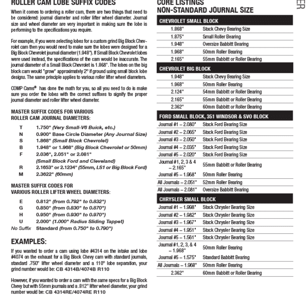

It's hydraulic FT alright. Magnum (.842) lobes. What's interesting to me, the 'B' suffix after the lobe number was used on roller lobes for specifying journal sizes, but that doesn't mean they haven't changed their numbering or added that feature to standard lobes since my catalog. Like someone else mentioned the 'H' after the lobe numbers is for hydraulic....ooh you know who "might" know about Comp's lobes? @PRHeads
If it was run on a dyno, it was broken in on the dyno. If the cam was going to go flat, it would be within the first minute of operation.
Yes and no....1969 needs to continue to run the proper oil or it can go flat in the future.
journal size, or base circle size?
Mine showed it as a journal size spec--but see it's only for roller lobes. The page that lists OPs "5908" lobe doesn't show the suffix options. Roller lobe page does but the lobe numbers are totally different.
