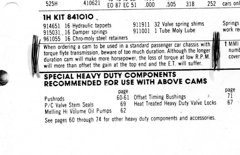

383/440 has the one of the highest Rod/stroke ratios of the big block engines. They do not tolerate lots of duration, which is why this warning is in a cam catalog.
