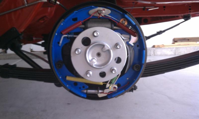

They guy that did my diff and housing wanted to do my brakes, but they are so easy I declined. One thing to make it easier is a brake spring tool, makes it a snap when putting on the brake springs, the red ones in the picture below. You can use a screw driver, but it will slip off, and you don't want a stinger from one of these springs! So much easier to spend the 10 bucks for a tool if you don't have one.
Here is what mine look like if you need a reference.
