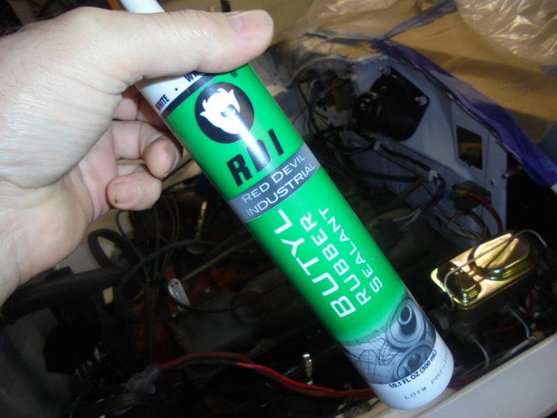

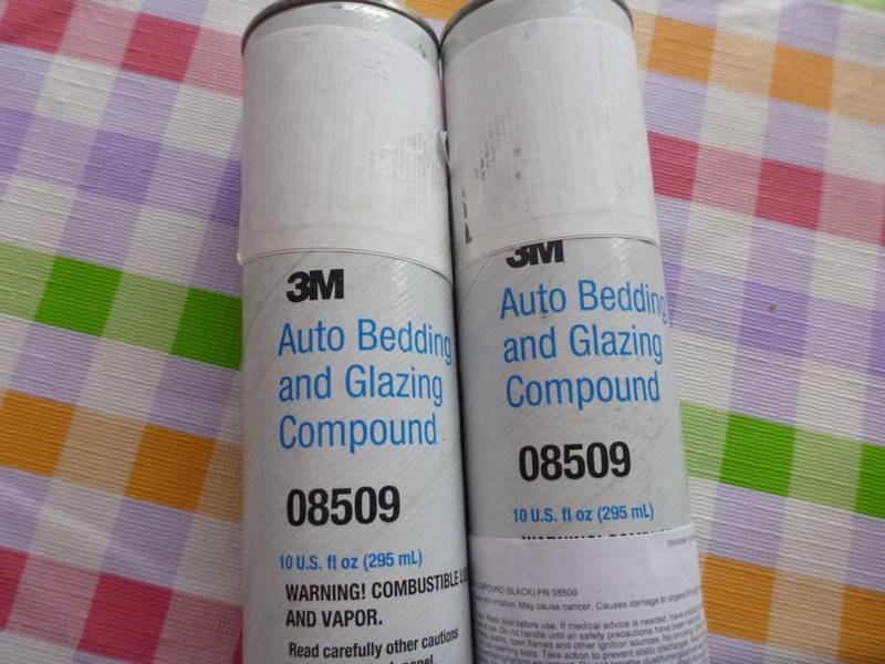

OE rear window in 68/69/70 and probably others is installed with butyl tape (3/8" for Coronet), not urethane. Front windshield gaskets sealed along bottom and part way up the sides with 3m8509
