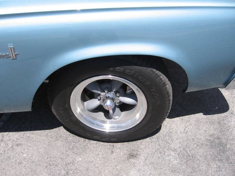

Photo is of my 65 with 225/70/15 on a 7'' wheel with a 4'' back space. No problem.
