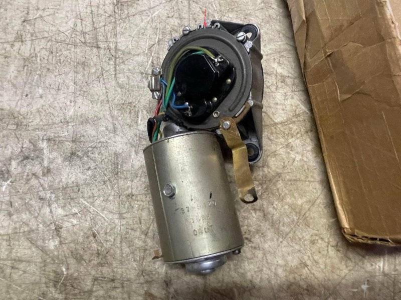

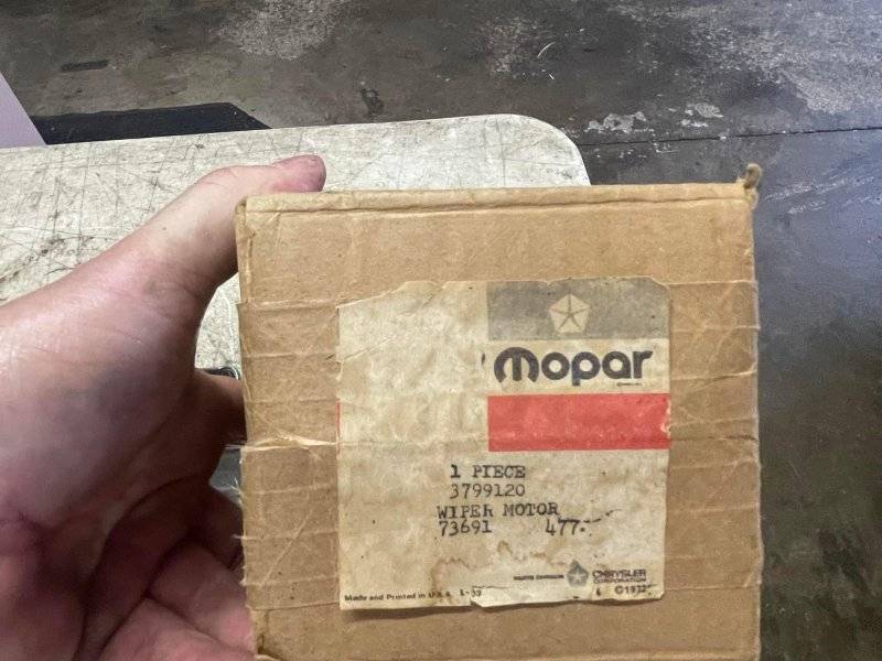

Anyone know what it would take to use this 76 F-Body 3-speed wiper motor in my 70 B-body?
Would I just use the 70 Pivot arm, cam bushing, switch?
Thanks!

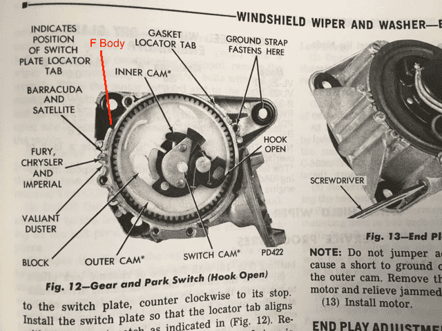

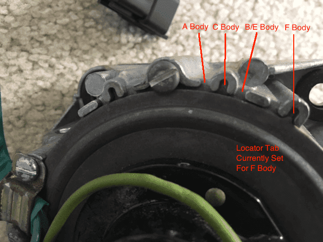

It will work with the correct arm. I marked up your photo indicating what notch the cover tab goes in.
The three speed motor is interchangeable between the different years and bodies.

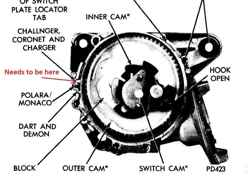

The notches on the housing are used to clock it for different vehicles. I don't know how it translates from 60's to 70's.

Althought the top plate changed between 72 and 73 years ( laters with the black tower on plate as far I recall due a redesign on the parking system ) it seems can be interchanged
