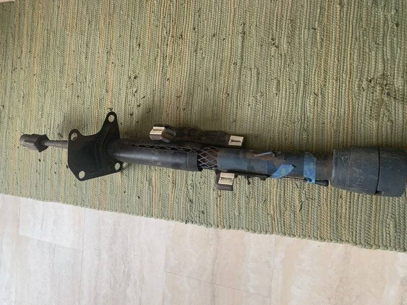

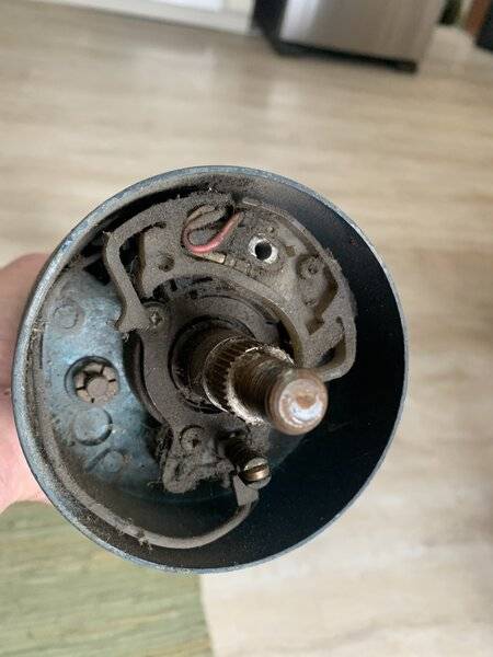

I need help identifying this column. Year, model, floor shift?, column shift?, Auto?, Manual?, power steering?, manual steering?. What's it worth? Thanks for your help.

Looks like the column in my Charger, floor shift column
67-69, floor shift, if the pictures can be taken as accurate, probably power steering.
It is earlier than a 1970. No ignition key.
67, first year for collapsible column.
@Jerry Hall Pictures are accurate, I just took them. What identifies it as a 67? Just trying to learn. Thanks.
Shorter shafts on power steering since the steering gear is physically larger.

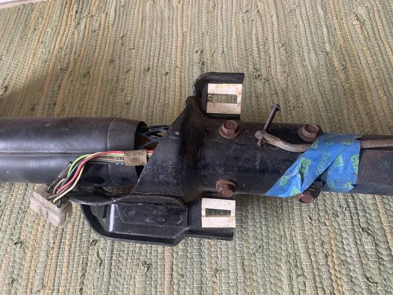

I just noticed the wiring connector, not a 67 from that viewpoint. 68-69, or when they switched from the flat connector.

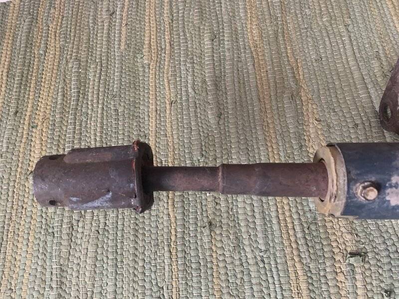

wrong lower bearing for 67 so 1968 or 69 B body column looks short,, so would say power steering column
