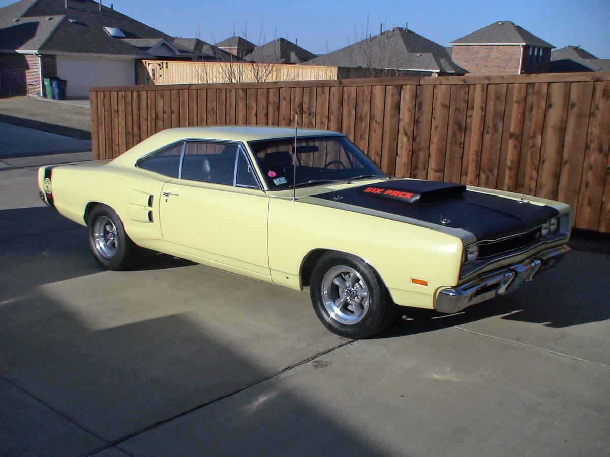

Backspace is the distance from the inner mounting surface of the wheel to the inner lip of the wheel. The deeper the backspace, the deeper in the wheel well it will sit. If you go too deep on the backspace, the tire might hit the leak spring. Too short of a backspace, and the tire might hit the inner fender lip. If you want a more traditional look, you can go with 15x8 wheels on the rear, and 15x7 on the front, both with 3.75 to 4" backspace. For tires, a good match is 275/60-15 rear and 235/60-15 front. That is what we just put on our 69 Super Bee.
