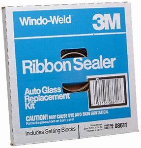

local parts store should carry this

If you do it make sure the window adhesive is compatible with the sealer.
The joint would be to wide for silicone. A backer rope and urethane sealant would be the best option.
I wouldn’t recommend it. Not sure your car, but after spending several hours picking tiny glass pieces out of a race track when a guy in a Javelin decided to roll down his window after the finish line... no.
No tape kits. Only use that to seal gaskets.
