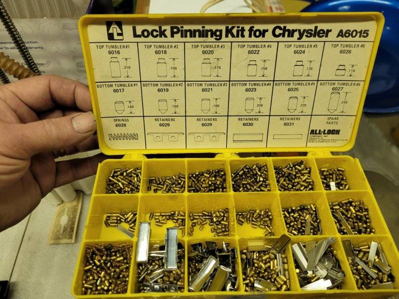

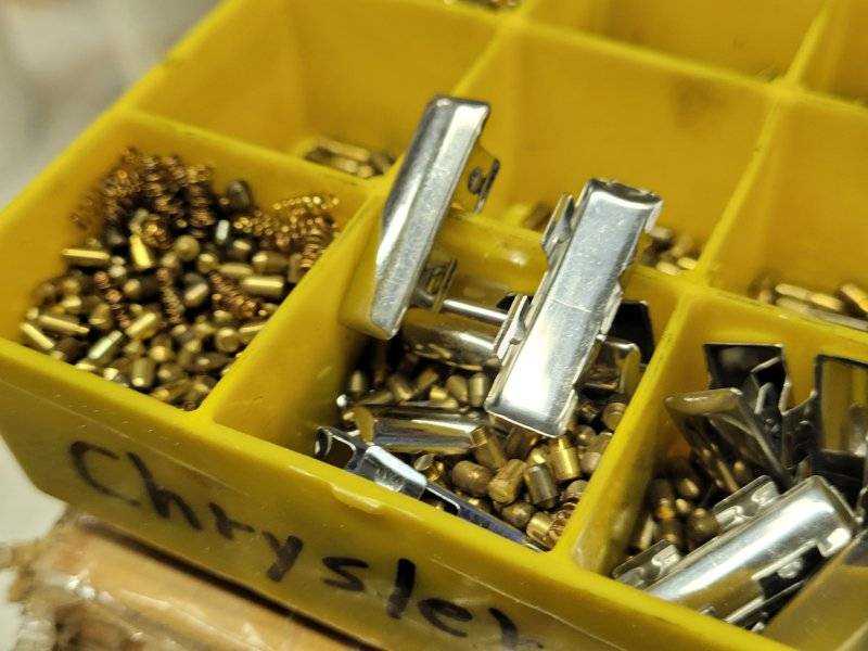

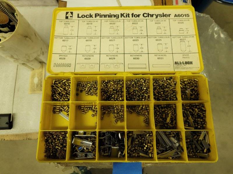

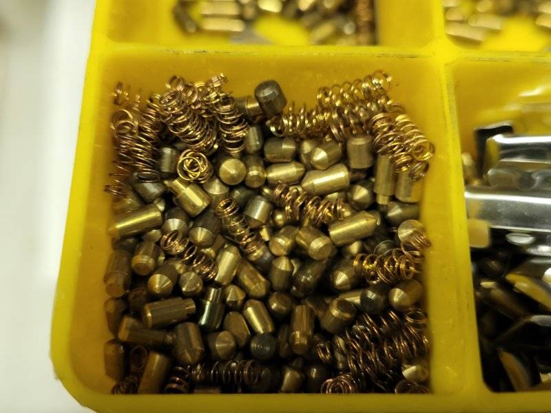

The dealers had kit that had all the different tumblers in it and a tool that would measure the points(?) on the keys. They could then match up tumblers to the key.
